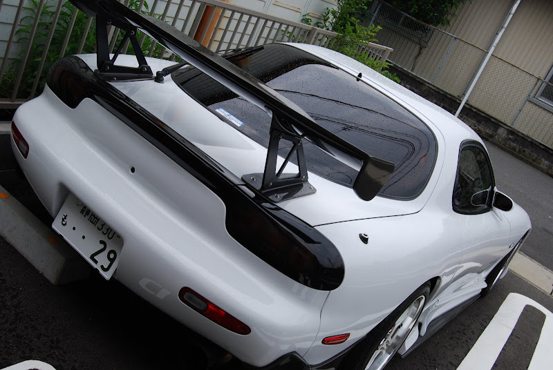

Exterior:
RE-Amemiya front bumper N1
RE-Amemiya Side diffuser wet carbon
RE-Amemiya Super Canard (rear bumper) carbon fiber
RE-Amemiya GT3 Rear wing spoiler carbon fiber

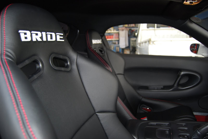

Bride PROS Full bucket Seats

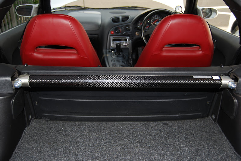

RE-Amemiya rear strut tower bar

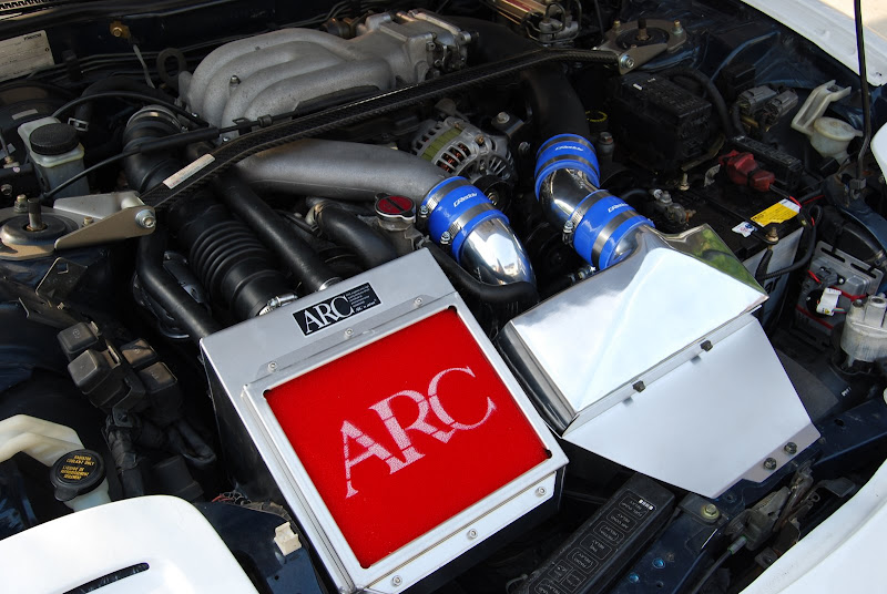

6th gen. turbo piping (kouki)
6th gen. air pump
6th gen. radiator and radiator fan
Spirit R differential 4.1=>4.3
Rebuilt alternator
Blitz Nur Spec cat back
Apexi Power FC with full remap
HKS Type-1 Turbo timer
HKS SSQV II Blow off valve

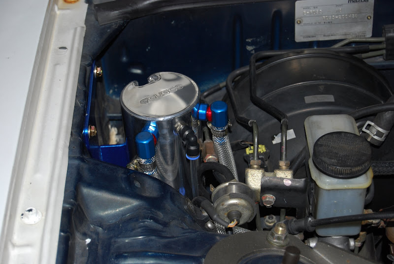

Cusco Oil Catch tank
GReddy Aluminium piping
RE-Amemiya AST
GReddy Intercooler
Okabe Jidosha special made air duct

Sur le parking devant chez moi:
En extérieur:

Barre arrière montée:

Sièges Bride montés:

Ca prend l'air directement dans les ouvertures juste en dessus de la plaque:
